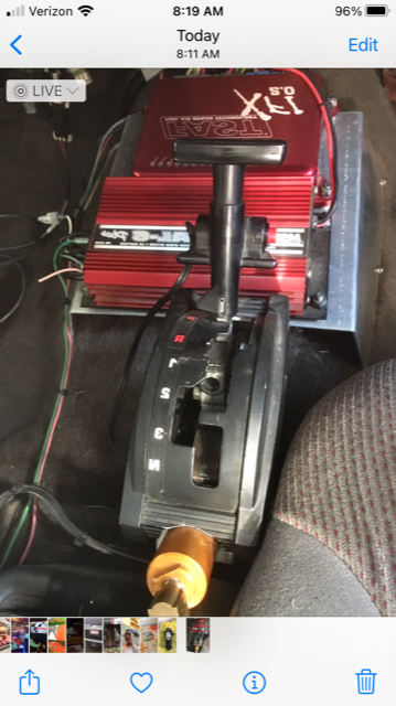

Originally Posted by Eric Merryfield View Post
I use a ACD controller, co 2 system with my classic turbo action shifter, with clean nuetral, in the dakota, dart has newer style ta shifter same setup, both work great.
Did Paul Forte modify your TA for clean neutral, surely not just a shifter plate?
Here she is
Its not altered, for the air shift, a spring is altered. I used to run it shifting myself, which was ideal, except for the straight 2-3 was too soft and I could too easily go from 1 to 3. If I had to do it again, I'd likely alter the shift pattern with some sheet metal like some have done to keep that from happening.
