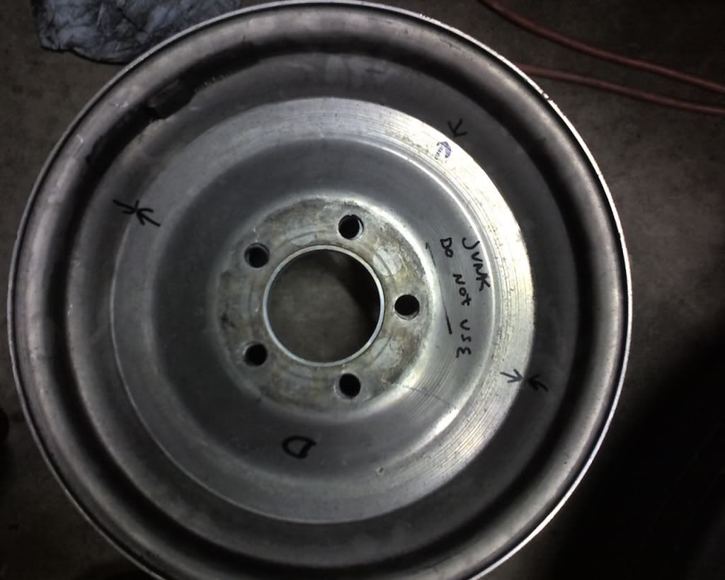

While getting ready for the 2009 racing year I found one of my front wheels broken on the inside.
If anyone has these wheels I would suggest that you check them.

I heard a clicking sound coasting back from a run and went back to the pits to see what the mysterious noise was. It was the inside of the rim cracked 3/4 of the way around the rim. These were an older set and the back side was flatter than the newer set I had, but I was very lucky. This is on a 66 Nova SBC combo so it isn't a very nose heavy car or one that the front wheels can even turn much and side load. If you run these rims, check them out!

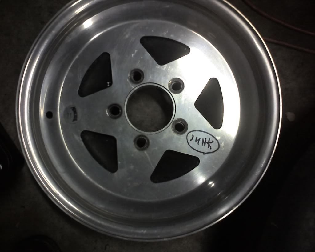

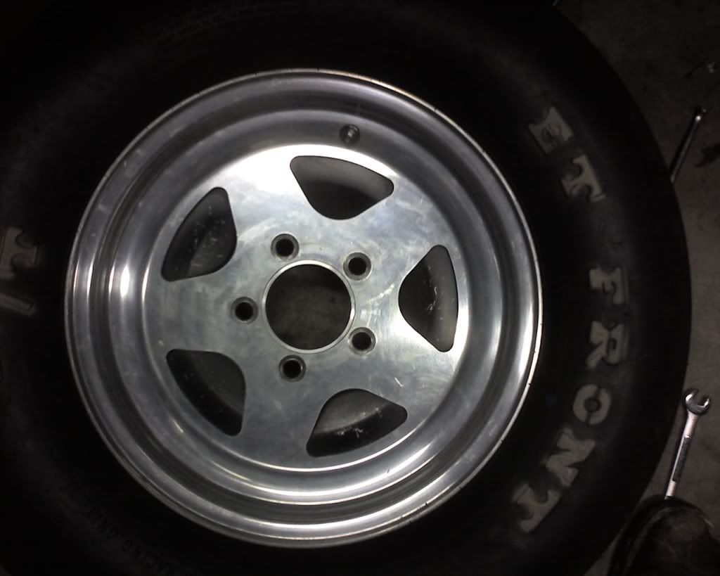

Here are the pictures of the older (and broken) Monocoque front rim and the newer upgraded/not broken rims from our Chevy II that Jim mentioned in an earlier post. We never had any trouble with the upgraded version but we have replaced them this year.
old rim
new rim
old rim (broken areas in black marker)

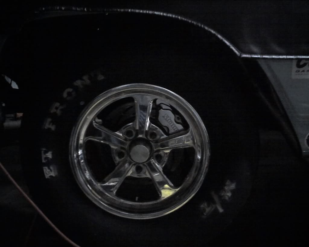

Here is what we replaced them with for 2009
