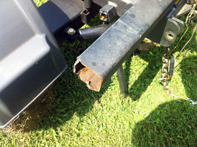

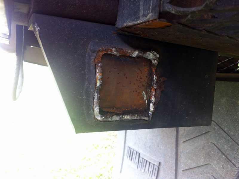

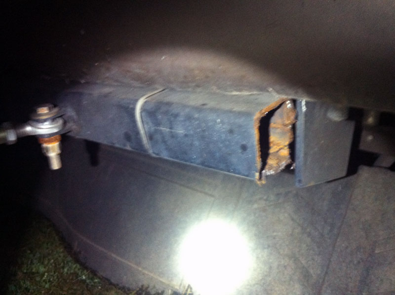

Finally got some pictures uploaded.

By the looks of the pictures you were lucky with the rust it was cracked for sometime. Good luck with the repairs.

daaammmmmm, prob. good thing you had the toad. or do you think the side loads of reverse may have had something to do with it? it didn't brake the weld. anyway, good luck and be safe, time to go look under the motorhome....
Honestly. It's the fact that it wasn't braced up, even with the toad it needs to be braced to the frame pretty well. It tore it off like it was no big deal while turning into our pit spot. Luckily the other side held long enough to get it up off the road. The second side pulled off without much effort this morning.
We will have it repaired and braced on Monday thanks to some fellow racers that put us in touch with the right people.
Everyone should be keeping a good eye on their hitches on RVs pulling any trailer. The stacker pulled it off like it was butter!
