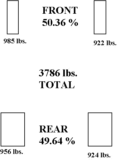

Setup like Stocker except with 493" 13.5cr power plant and glass hood @ ~3707lbs. I have about 450+ passes in the car. It has Strange Double Adjustables up Front, CalTrac Mono-Leafs, Rancho 5-Way Rear and CalTrac Bars. I have 5.25" of range in front with .840 T-Bars. PTC 9" @ 5200rpm. It's went 9.93@135 with 1.404 60' at ~800DA on 9" x 94"circ Hoosier Radials C06 and no exhaust. I just got my new Hoosier C07s mounted. Running 26" tires up front.
1. I have about another .5" of travel I can add in the front, making the total 5.75" before wheels leave the ground. Since I'm running the .990 T-Bars, I'm not sure if I gain much since I would be taking some of the preload out of those small bars. Any opinions there? More front end travel vs more pre-load?
2. I'm 50.36% Front and 49.64% Rear in current config w/ driver. LF 965 -- RF 902 -- LR 936 -- RR 904. I have about +.5" difference in rear ride hight measured at the fenderwell favoring high on the Drivers Side. Should I attempt to balance that out tightening up passenger side T-Bar, or loosening up the Driver side? See attached.
Trying to get her in the 1.3x's for 60' for OpenComp and Bracket racing. Need to really scrub about .010-.020 in rollout as well for OpenComp off the footbrake. Options, ideas and opinions welcome.

A few things you can try, reduce the front end travel with a limiter, leave the torsion bars alone.
Tighten up the shocks, both front and rear.
Run a few more pounds of air in the slicks.
Most effective thing is to remove some weight if you can. If you make the car 100 lbs. lighter it will react much different. If you can't take it out, move it around so you can make the other adjustments without sacrificing traction.
All these changes will effect the traction, but limiting body motion will make the car move forward. To much and it will spin, it's a fine line and track conditions need to be considered.
Get out there and test!

What George said, you want to minimize front extension, loosening front shocks is going to slow reaction; all depending on it still hooking of course...a wider stiffer slick will help as well.
