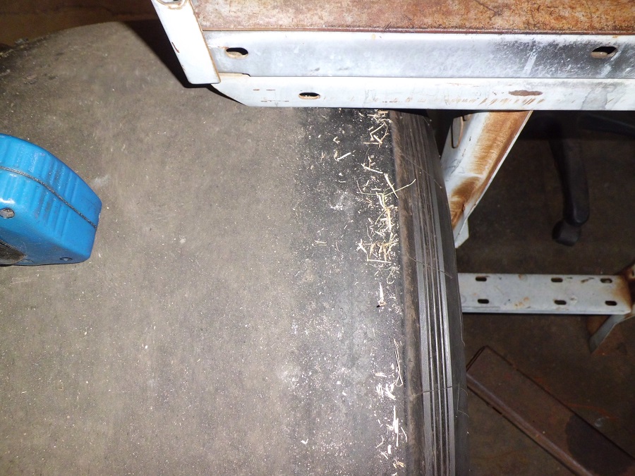

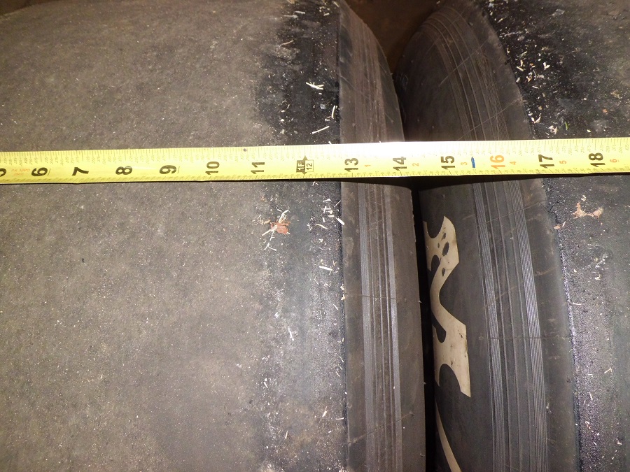

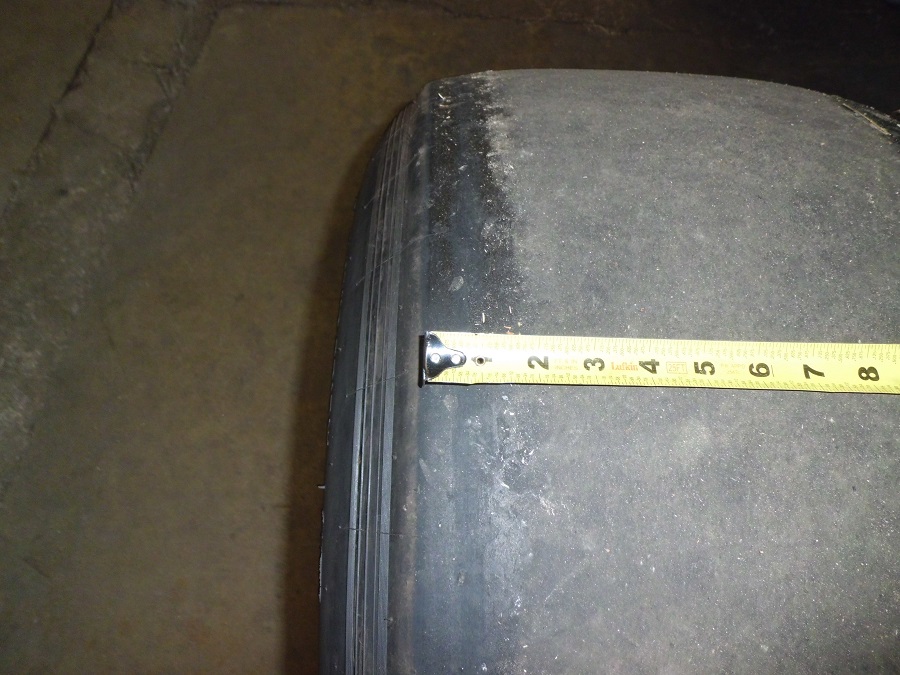

Notes:
*15" wide wheel
*M/T #3073R 31.25/12.2R15W
*first 15 pounds then 18 pounds
*about 1.25" on each side of each tire has never touched the track
*3170 race weight
*nice smooth wheelie down before 60' clocks
*1.39 - 60 foot
* 10.40 ET

An above post suggest running the same air as I ran with bias tires [10 pounds] and judging by the photos that is good advice.
Truck is smooth and straight with bias tire.
Larry Woodfin 471W
