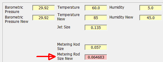

Can someone post up what the weather is when they run a 0.057" rod and when they run a 0.066" rod? Looking to see how far off my math is.
Stan
