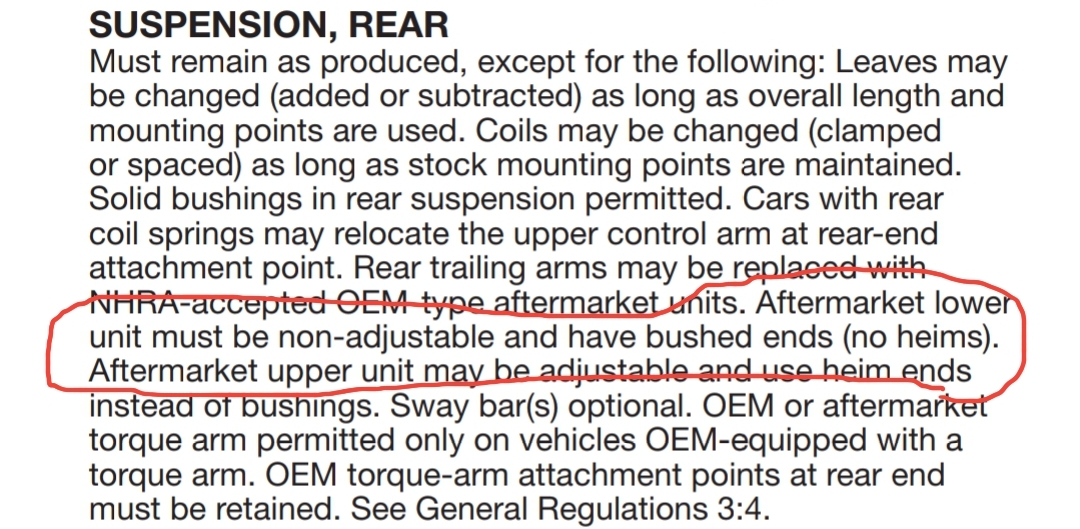

Old 11-01-2020, 04:42 PM   #6
Jeremy K
Join Date: Nov 2009
Location: Bridgewater, NS, Canada
Posts: 79
Default Re: Rear lower control arm bushings 99-02 firebird
Originally Posted by Jason Shepard View Post
The only thing I could find says they cannot be adjustable. Otherwise no other restrictions
This is the exact wording.
Jeremy K is offline   Reply With Quote
Old 11-01-2020, 05:57 PM   #7
SSDiv6
Join Date: Feb 2003
Location: Glendale, Arizona
Posts: 3,045
Likes: 712
Liked 1,595 Times in 583 Posts
The Global West lower control bars are not adjustable and meet the rule.
I believe what Tom was referring is to the interpretation and language of spherical bearing versus solid bushing.
The only difference is the spherical bearing has reduced friction when compared to thermoplastic bushing with a steel sleeve insert for rotation. Needle bearings are being allowed in front control arms in lieu of bushings; to me, there is no difference.
The Global West bars are great pieces and work. Also, BMR has non-adjustable lower bars with the thermoplastic bushings and even has some "Scratch and Dent" bars on sale.
http://m.bmrsuspension.com/?page=pro...productid=2312

Old 11-02-2020, 02:28 PM   #10
Tom Goldman
Tom Goldman's Avatar
Join Date: Jan 2003
Location: Allentown,PA
Posts: 2,477
Likes: 892
Liked 883 Times in 237 Posts
And there you have it , a Heim end is a spherical bearing ,the Global West arms are spherical does not matter if its non adjustable .
Don't get me wrong , I would love to use them on my Stock customers cars, I've inquired about them as recently as earlier this year. but here is where the "East Coast vs West Coast" rule books come into play , A matter of interpretation .
I won't risk a customers DQ for what is most likely a negligible gain over a bushing.
