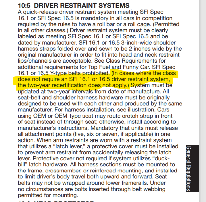

Originally Posted by SDT1DYI View Post
Can not offer any mounting suggestions but I wanted to pass along belt certification info.
You can use a 5 point out dated belt in N and slower classes.
Not all Track tech inspectors are aware of this. This came directly from our NHRA Tech Director.
Steve Teeter STK/SS 620
Is this in writing somewhere to show uninformed tech inspectors?
It's in the rule book.
