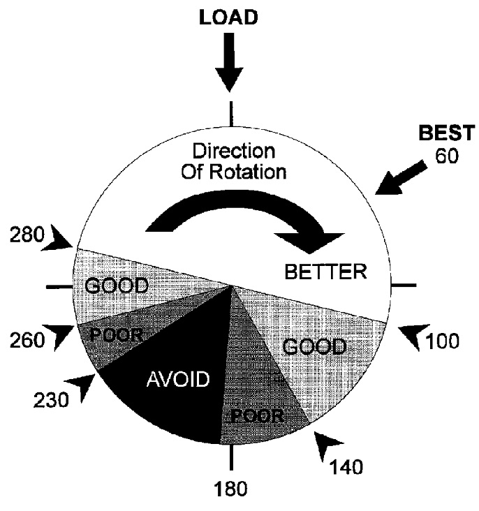

putting together a '66 327 stocker engine. most guys put the oil hole in #s2,3 & 4 straight down, 6:00. I always put the oil hole at 3:30. believing that the journal could get a bit more oil before the Big load, at 6:00.
thoughts?

2 o clock

Here is a diagram from the Durabond web site
Name:	cam bearing holes small file.jpg

thanks for the replies. especially the pie chart. this small town kid wasnt far off.

Put #1-5 all in at 2 oclock
