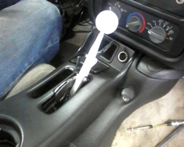

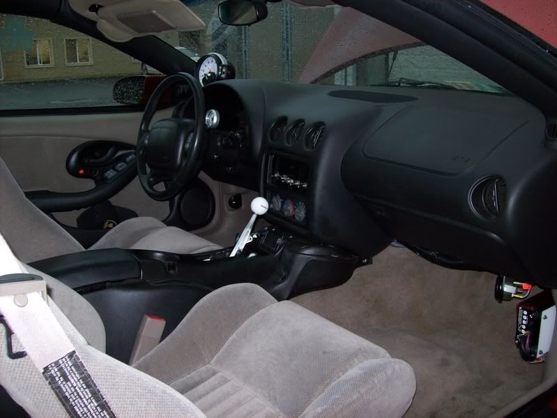

I have seen a lot of guys fit a quarter stick in the factory console in 3rd Gens. Here are 2 pictures of one in our 4th Gen.

Old 01-06-2009, 06:05 PM   #5
Dragsinger
Join Date: Jul 2008
Posts: 1,760
Liked 99 Times in 60 Posts
Default Re: shifter in factory console, 3rd Gen Camaro/Firebird
Lee,
Thanks, looks good.
Also, what is the gauge near the right kick panel?
Larry
Originally Posted by Dragsinger View Post
Lee,
Thanks, looks good.
Larry
Thanks Larry!
The gauge is a water temp gauge.
