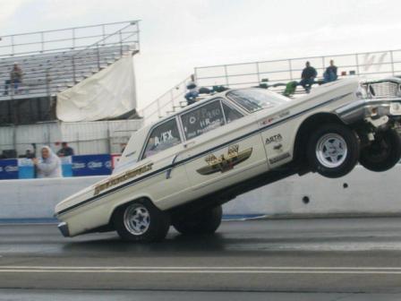

Legal or not, they sure are ugly.... just my opinion.
Agreed....... I think they really ruin the look of older cars.
Here's a real 64 T-Bolt that don't need no stinkin' wheelie bars!
Dale Posnick
