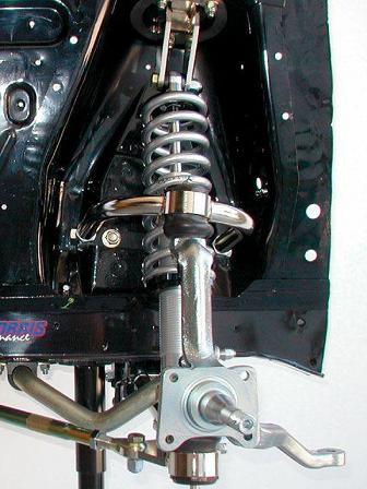

Then would this be acceptable on my mustang?
Name:	mufp_0710_24_z+classic_ford_mustang_coilover_suspension+ron_morris_performance.jpg

No it does not use the stock spindle or mounting point, but maybe the west coast rule book said its ok. Tom

Something similar to this was proposed for early Mustang and Comet chassis's a couple of years ago and was rejected. Seems like a double standard if this is legal now.
