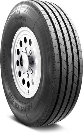

Been running Maxxis 8008 10 ply load range E. Would like a little more tire but cannot go to 16" due to spread axle and fenderettes on my ATC trailer.
Hercules has a 12ply load range F in the 225/75r15.
Has anyone run this tire? It is fairly new so not many reviews.

Hercules Tire has been making products in Findley, Ohio as part of the Cooper Tire and Rubber Company for many years, so they are are (or should be) a reputable brand. They have a large dealer network, so maybe that would be a good place to ask about their warranty/replacement policy.

The Hercules specs show that size as 10 ply, not 12 ply and with the same load rating as Maxxis in that size. I’ve had good luck with Maxxis and since I’m restricted by size think I’ll stick with what’s worked for me. Goodyear? Not so much...

You need to look again, the link I pasted
95135 ST225/75R15 12ply 121/118 F 3200@95 2910@95 28.17 47.44
Tire Size ST225/75R15/12
Load Index 112/118
Speed Rating L
Load ID F
Sidewall BW
Min Rim Width (in) 6
Max Rim Width (in) 6
Overall Width (in) 8.98
Overall Diameter (in) 28.17

Seams like a good trailer tire did you buy them ?

I got one of those tires as a spair . It's a heavy duty tire & you need a 6 wide rim .

We installed the Hercules 235/85 r16 on our trailer Which was same size as the trailer manufacturer recommendation . Got a good deal, but found that the side walls had more of a buldge and had to beat the crap out of the inner fender to keep from rubbing.
