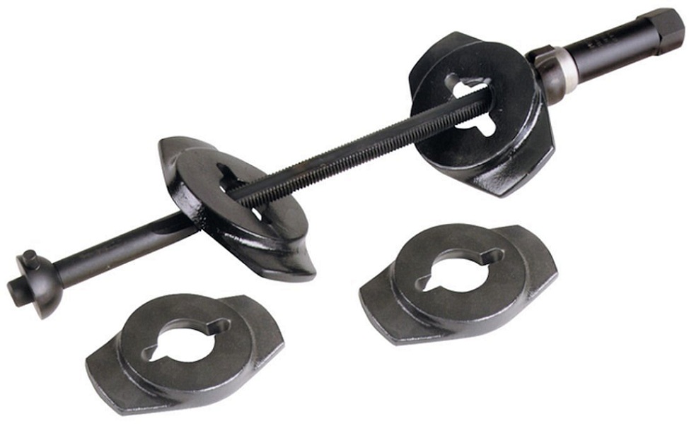

I would recommend purchasing one of these OTC coil spring compressors: http://www.amazon.com/OTC-7045B-Fron...ing+compressor
I purchased one online from Amazon.com and it works fantastic, I don't fear for my life when I use it like I used to with the "hook" type compressor. This one compresses the spring almost effortlessly with a crescent wrench. I have had my front springs in and out several times on a 79 Malibu with this tool, I love it.
Name:	Spring Compressor.jpg
