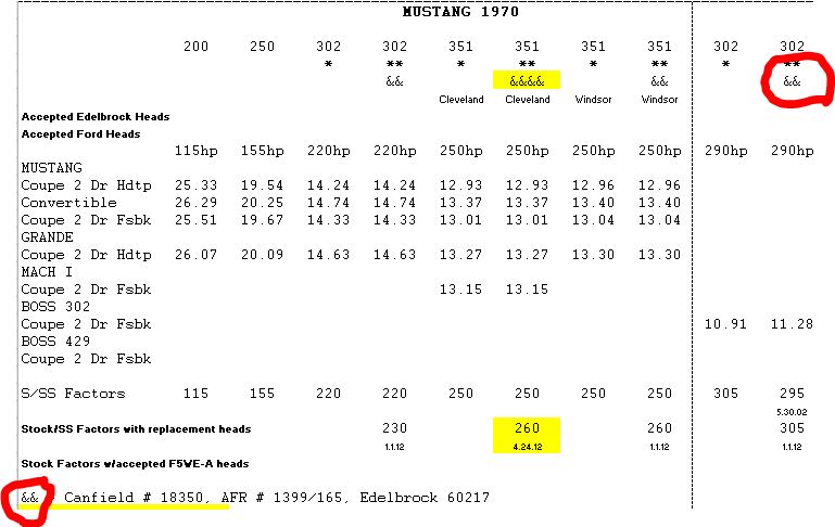

This is not true. The inline aftermarket heads are listed as acceptable for Boss 302 engine in SS for 1970.
