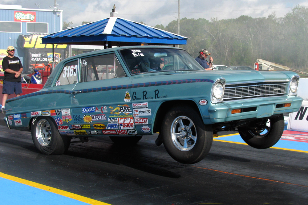

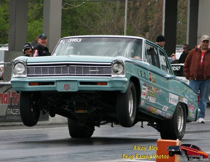

How do all the ss/k novas keep their front tires so close to 0 or pos camber when they launch with the wheels in the air. Diff ball joints, control arms?

To correct bump steer and toe drag problems on 1967 and older Chevy II's, I still build a tie rod kit for these cars. It is a bolt on kit, no bending or other hassles. It comes with an instruction sheet on how to align the front. Just bolt it in, align the front end and go racing. I did a lot of research, and built these things back in the 70's and 80's when I raced Super Stock. For more info about this set up, you can send me a P.M. or email me at eddierezac@yahoo.com

x2 on contacting Eddie. Purchased a kit from him a while back for 66 2dr sedan and it made a world of difference.

X3 for Eddie. He does an incredible job. Just bolt it in. Get an alignment. And go racing.

Yep
