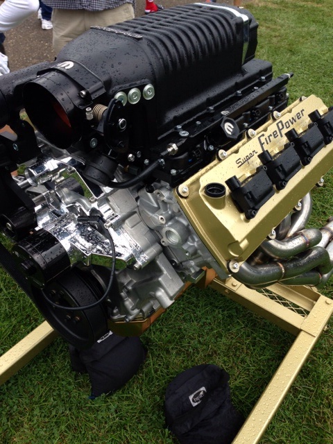

Supposedly there will be 2 different 2015 Drag Paks. 1 N/A and one supercharged. Not really "Hellcat" engines, but badder. Rumor is the factory rating is 290 HP.

jeff,i have an invoice sheet on a challenger that says 6.2l is that correct 2015 biggg

6.2 Blown is the Hellcat. Don't know which heads are on it.
