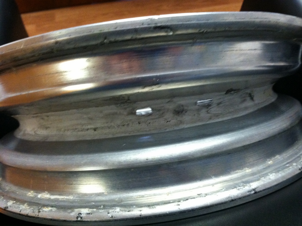

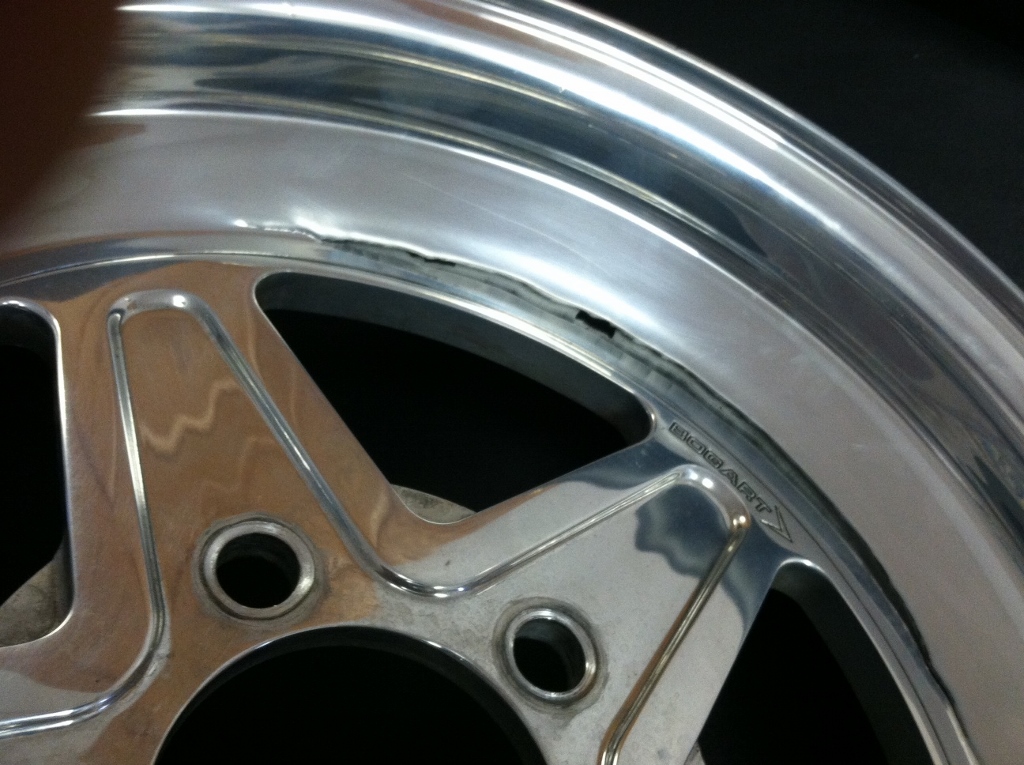

Anyone running Bogart R/T wheels needs to keep a close eye on them. My right front split on me Friday night, fortunately on an 1/8 mile track. The tire came off the rim before I could completely stop ruining the tire. I checked the left wheel and it has a crack started in it as well. If this had happened a few seconds earlier or had I been on a 1/4 mile track I would have crashed the car most likely. Hopefully the pictures will post ok.

Alex,
I did talk to Rich late yesterday about this. I'm sending the wheels to him so they can put a thicker outer hoop on the wheels. Probably won't have them back for Indy but I Keith Lynch has an extra set of light weight wheels I can use if needed. I appreciate the call yesterday Alex, hope to see you all at the track!

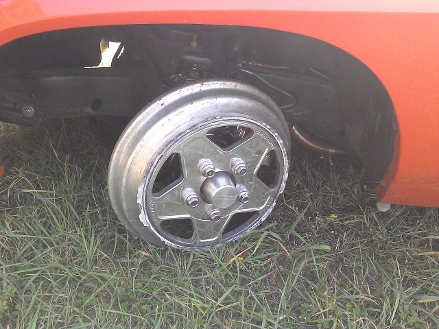

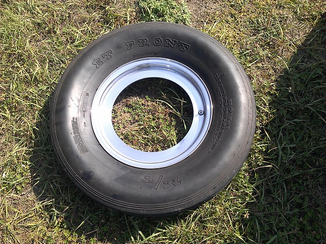

I had this happen to me last year the tire with the outside bead of the wheel flew off the car.
It sounded like a 12 gauge shot gun going off and then the car fell down.
Luckily I was on the return road away from people and vehicles.
The car suffered no damage. But it scared the heck outta me.
The wheel did not shake, leak air or any thing to indicate it was failing.
CRAZY!!
Thank GOD no one was hurt.
