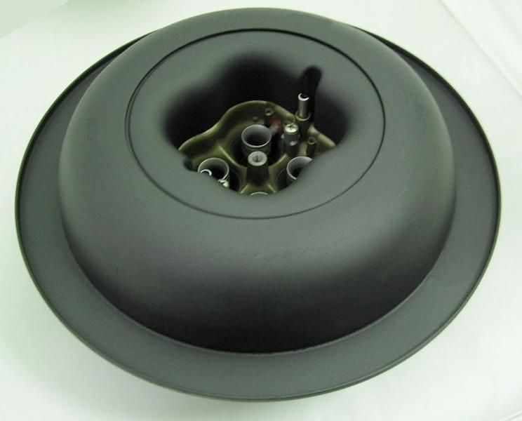

Legal? http://www.r2cperformance.com/produc...?ProductId=264
http://www.speedwaymotors.com/R2C-Pe...-14,70686.html
Rich Taylor

I think tech. would consider that base the same as they do a K&N Stub Stack. -Al
How about this version? These folks are supposedly working on Quadrajet parts as well.
