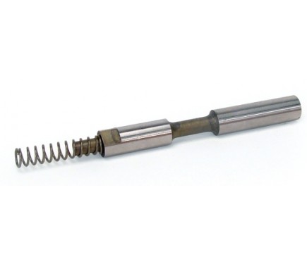

This is what I mean by a "pin". The solenoid pushes this valve in when it's engaged to lock your trans. It's milled differently from a stock valve. What we keep calling a TB solenoid is a modulator valve on a stock auto trans. It's run (usually) off a vacuum line and changes flow of fluid in the trans depending on how hard the engine is working.
If this piece is sticking or the return spring is weak, it would slow your TB response time.
This part is from a TH 350 TB from TCI.

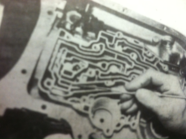

I didn't mention in my response to your question which was also on the .90 tech forum, If you are using a TCI brake the removal of the casting wall is critical for proper release .
I have had a trans in the shop that did not have this done and it was slow , not to your extreme , but slow.
Also how does the trans engage and release reverse ? does it react normally ?
If reverse is abnormal so will be brake release.
JW brakes also require the use of their regulator spring and reverse /rear accumulator spring.
here's a shot of the divider that must be removed for the TCI brake.
