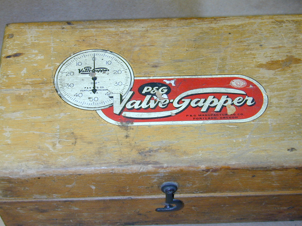

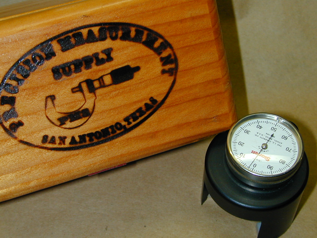

Setting valve lash with a "feeler" gage can easily be all over the map when it comes to accuracy. Depending on valve train deflection, a racer might want to more precisely set the valve lash with either an old P&G valve gapper or one of the more recent pieces from Precision Measurement Supply in San Antonio.
Regards,
Dissident
Hope the pics attached ok.
