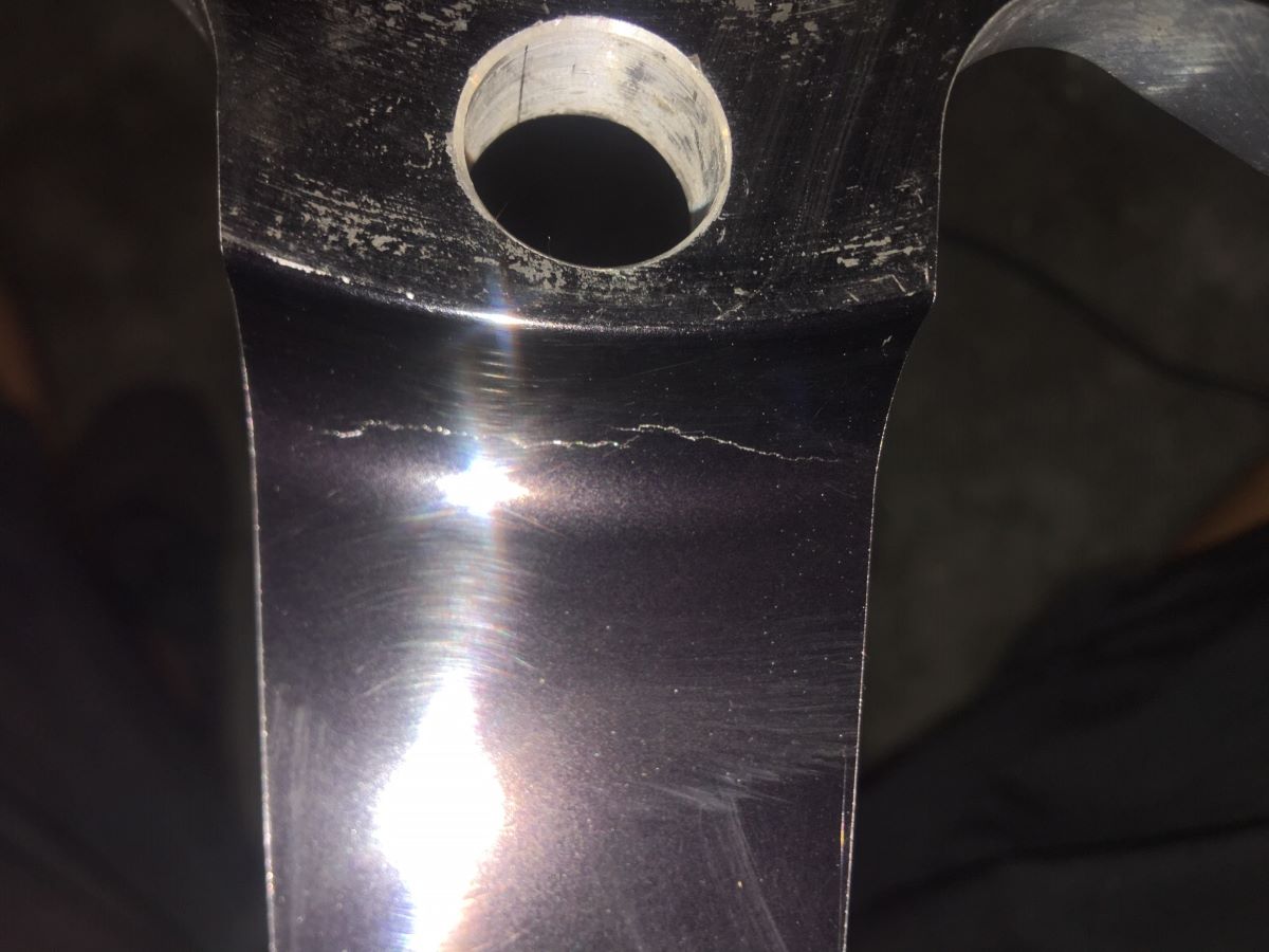

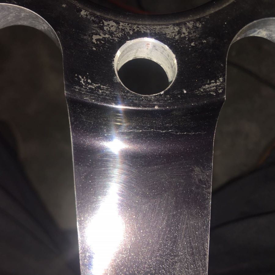

I just wanted to make everyone aware of an issue I had late last week. I was cleaning the race car and had removed the front wheels to clean them and found small cracks near the hub of the wheel on the inside. Each wheel had these all in the same location. I know other racers have had issues with front wheels before but just a friendly reminder to look them over. This could of been costly if I had not found this. These were black anodized Weld Alumastar wheels that I have had for 7 years.

Inspect your wheels regularly as all these lightweight, front billet wheels crack regardless of manufacturer, some rear wheels too. If you're lucky, you find the crack before it fails and you crash as some have. I've had 2 pairs of Weld Magnum wheels crack, one wheel broke and exited the wheel well as I was tuning into my pit spot after just having made a pass. I know racers that have also had V series crack as well.

Thanks, I will be checking mine this week, good pics showing the cracks too

If you have Bogart fly's with the black back plate,check them often bad for cracking!. gsa612

Default Re: Cracked front wheels
Weld did nothing, told me their wheels have a 30 day warranty for manufacturer defects. Which means they have no real warranty. I replaced the broken/crack wheels with the same Magnum wheels but this set is black anodized.
Originally Posted by theman440 View Post
Anybody experience cracks with Weld Pro Stars?
We did last fall
One was leaking air is how we found it
Better that way then on the track
Both fronts were cracked
They were 17 years old so wasn't surprised.....

There are a lot of factors that will effect the longevity of drag racing wheels such as wheelstands, car weight, design of the wheel, material, fatigue and more.
The enclosed link, although it applies to non-wheelstanding cars, talks about the subject:
http://www.mcculloughpr.com/media_fi...Car_June16.pdf
