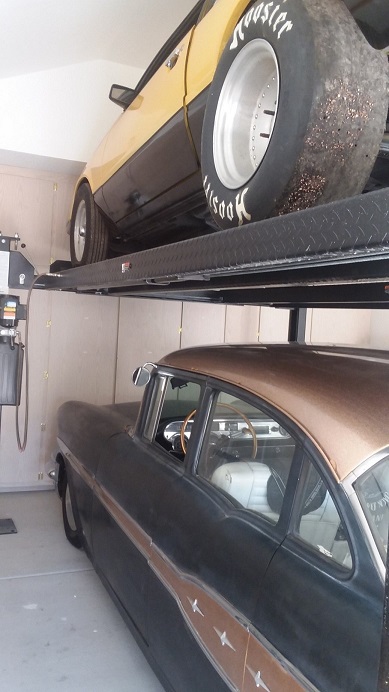

I had a 9 foot ceiling in my garage and had it raised 2 feet. Works really well.
