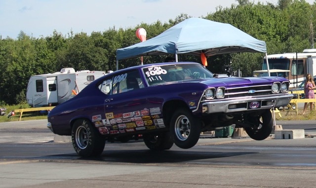

1969 Chevelle
F/SA 396/325HP (NHRA factored 316)
Car was originally 307/Glide, came from US. Car is good and solid but paint and body is showing it’s age. Other than small patches in 1/4’s and SS hood it’s original sheet metal. Have the flat hood to go with.
-Chassis-
-8 point mild steel roll bar tied into frame and lower control arm mounts
-Kirkey Seats
-Urethane body bushings
-Global West front control arm bushings
-Santhuff front springs, QA1 Stocker star front shocks
-Tubular rear control arms
-Tubular rear upper crossmember braces
-Rear Upper Arm relocaters on housing
-Strange Double adjustable rear shocks
-Wilwood super lite brakes all four corners
-12 bolt with Strange 33 spline spool and axles, Richmond 4.33 Pro gears, 1350 yoke
-1350 driveshaft
-Engine-
-Currently running as 396/325/316hp fits F/G/H
-Sleeved and grouted 454 4 bolt block
-GM Steel Crank
-Manley H-Beam rods
-JE Pistons with Total Seal thin stock legal ring pack
-290 casting heads by Armstrong. Manley severe duty valves, PAC conical springs and retainers, Comp 1/2” Stud rocker setup
-Bullet 54mm Steel Core cam
-Trend tool steel DLC coated lifters
-Trend Pushrods
-Deano Q-Jet
-MSD pro billet distributor, 7AL2, pro power coil, two step
-ATI Damper and flexplate.
-Approx 20 1/8 mile runs since last checkover, and 325hp cam installed. Under 100 runs total.
-Trans-
-Metric 200 3 speed with 2.75 low, JPT reverse pattern valve body, Alto clutches, Ultra bell (2 years old)
-ATI Treemaster Converter, 5300 flash stall
-Turbo Action Cheetah shifter
-TWRP Sheild (2 years old)
Car has recently been .70 under 1/8 mile index for F/SA as 396/325 combo, with more left. Should equate to approx .90/.95 under in 1/4 mile. This was with heavy oil and about 2000ft DA.
Last season went .79 under F/SA 1/4 mile with 396/350/335 combo. Comes with that camshaft as well. Fits E/F/G with this combo
-Spare Parts-
Comes with the following
-Bullet 54mm Steel core 396/350 cam (Factored 335hp)
-Pair of 063 Heads previously ran
-2 extra intakes (1969 Only- scarce)
-Flat hood
-Any other random associated stuff I find.
Car will need slicks and belts for next season- Other wise ready to go and should be a -1.00 under car in good weather or with some more tweaking.
Asking price $26000 USD or $35000 CAD
May be Interested in partial trades.
Contact Chris at 902-956-1962 or chippersperformance@gmail.com
