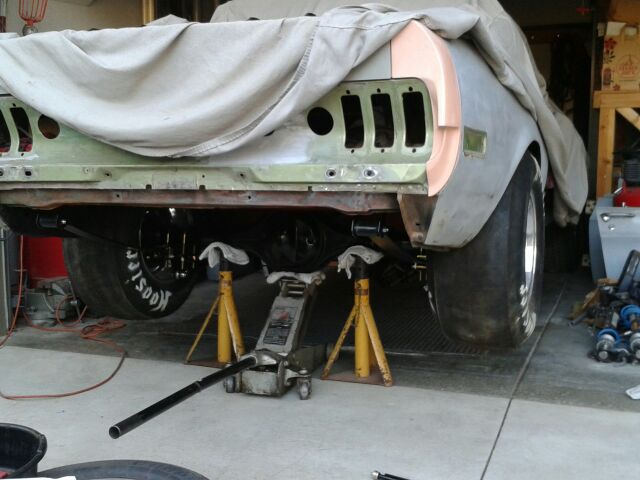

I started on one and I'm building it from scratch ('67 Shelby). It's taking a while since I'm spreading out the cost. you can email me at Mikeg@floorsbysignature.com
if you want to ask any questions. (I'm about 1/2 done and figuring it's going to be at least $40K)
Funny, that pic looks exactly like my garage tonight right down to the Cal Traks, jack stands and floor jack. I even have the passenger side door off my 68 coupe. Small world when you're having fun. Been working on it every day for a year now.
