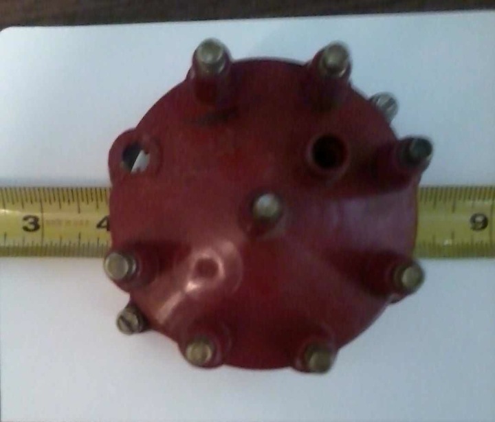

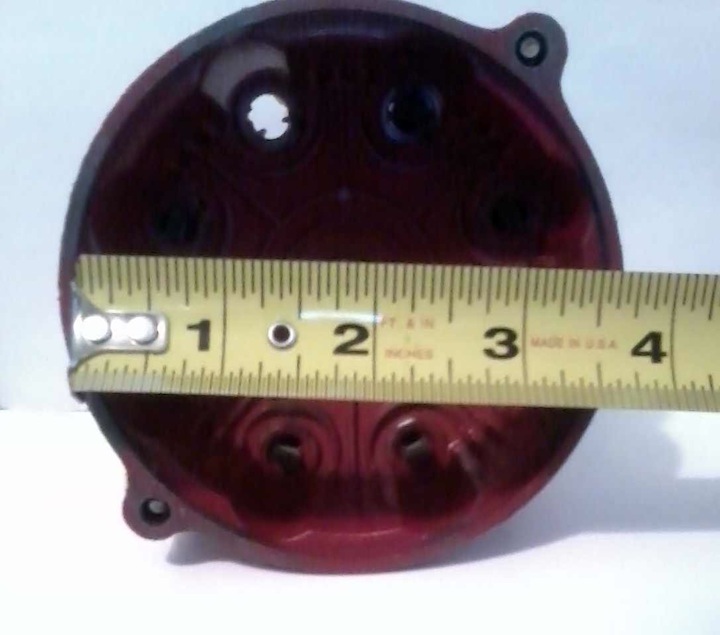

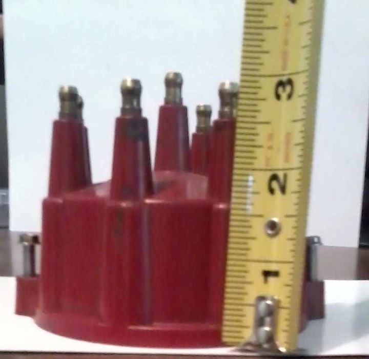

We've gone to several local parts houses and gone through the parts books with some of their "seasoned" personnel and looked at quite a few distributor caps. Some are very close, but all were either a bit too tall or the diameter was off by 1/8 of an inch or more. A tech rep from Accel tried to cross reference the Holley part number with no luck.
Attached are a few pictures of the cap with a broken terminal. The cap measures 3 7/8 inches outside diameter at the bottom of the cap, 3 9/16 inches inside diameter at the inside mounting surface, and about 3 inches tall.
Still looking and willing the chase any lead anyone can offer.
