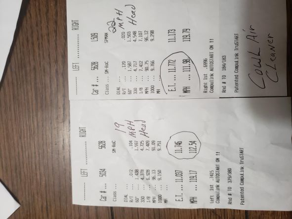

Default Re: Air Induction
I did some testing today at Heartland Park Topeka, not a good day to test but did get my clutch dialed in. A steady head wind 19MPH gusting to 26. fastest run 11.746 @ 112.54 made 6 runs, slowest 11.82 @110.85, last run of the day with the air induction air cleaner 11.772 @ 111.98 with 22 MPH head wind, and there was no starting line prep, bunch of street cars tracking water to the line all day. May have to try the cowl induction again Thursday in Noble Ok.
Randy Wells
I/S 5628
Name:	Heartland Park 3-20-22-2.jpg
