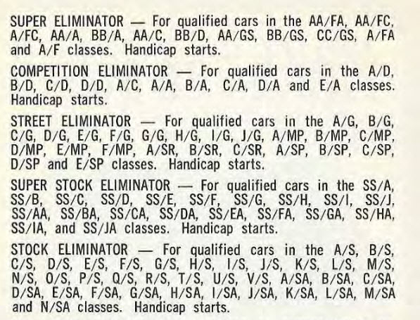

Originally Posted by Terry Cain View Post
Trying to remember how many Super Stock classes they had 67-71. Best I can remember it only went to D or maybe E. Remember the Camaro's running D. Maybe the Biscayne didn't fall in the upper classes in Super Stock. Also remember in Stock they ran B stick.
from the 1969 rulebook
