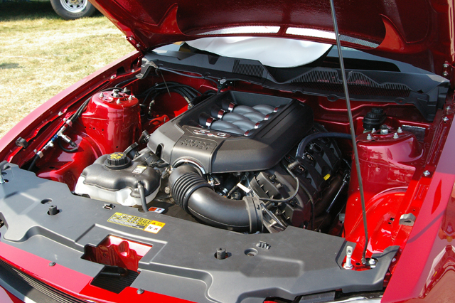

Jimmy Ronzello's Coyote motor at Indy.
ID:	9256   Click image for larger version

So I guess between Milan and Indy the throttle cable got taken off to pass tech?
