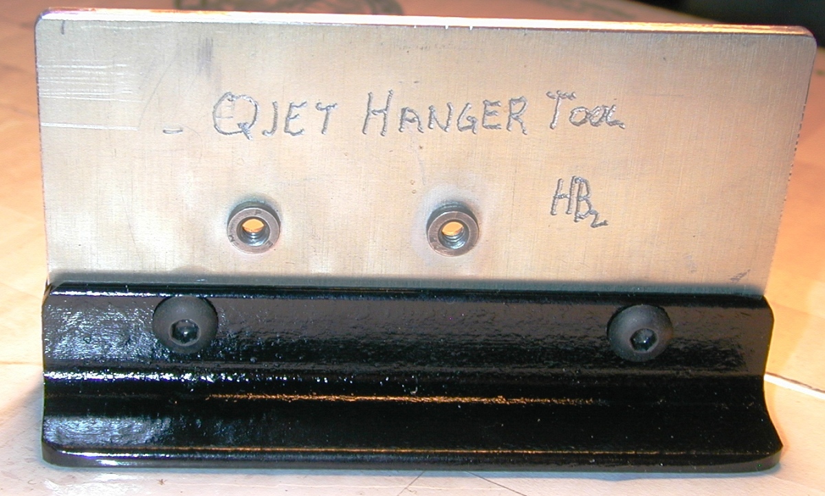

Forum Folks that might be interested in an easy solution to measuring QJet Hangers:
Easy to build out of scrap stuff. Center piece is 1/8" aluminum but could be steel or whatever. Bottom is built from couple of pieces of 3/4" x 1/8" angle iron so it is easy to keep upright when used. Will include a few photos for reference. Most folks do not need this kind of accuracy but it is easy to use anyway. Soon as I figure how to resize the pics that is.
Measure from the top surface to the pin (0.067" diam) with dial caliper.
Regards to All,
Dissident

I made up a fixture to measure the hanger dimensions. Pretty easy to do. I had several Q jets so I sectioned one so I could see exactly how the secondary rod changes with hanger letter changes. K, G etc.
What I experienced on the Dyno, using LL .040 tips rods , thinking I was riching the secondaries, it went lean. Dont understand why??? I found the primary side jet size numbers can be way off, BEST to flow every jet you have to know for sure which way you are really going with your jet changes.
Thanks to all that responded.
