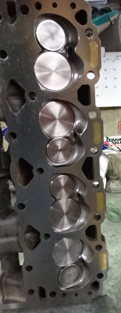

Need some ideas for filling in water trough sb chevy deck surface by spark plugs.

use torch with braze then mill or sand down. have this in my heads.

as you can see from the picture the braze was added into the spark plug cool holes and then milled.

Glenn…I have used BELZONA 1511 over the years. It is expensive but fast, functional, you can do it on the dining room table and machine or sand it in 24 hours. Once you buy it you'll be fixing the impossible with success. Hope this helps. Maurice.
