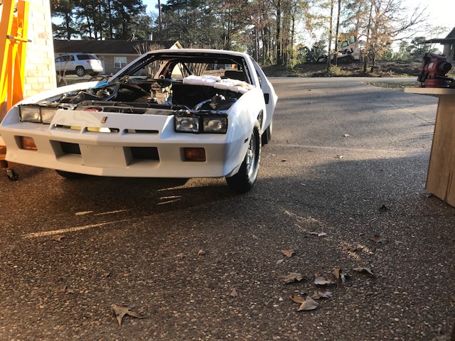

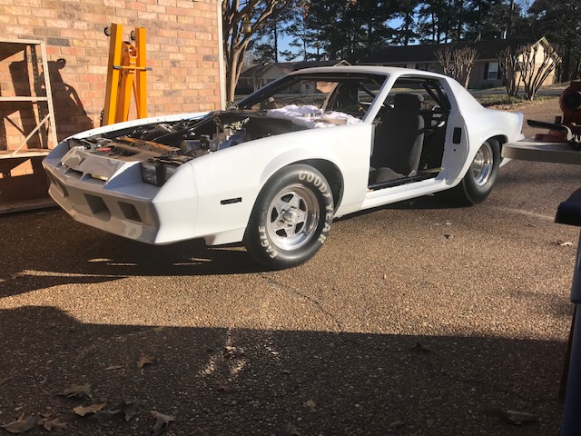

Stan,
1982 Camaro Berlinita
ID:	55219   Click image for larger version
Larry Woodfin 471W
