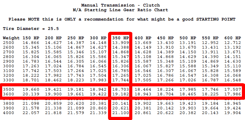

in Dick Millers book, the starting line ratio chart is interesting, but...
[target ratio is 11.25]
with my 2.64 low 4 speed, I would need a 4.56 gear. I cant believe that a 350 hp/3550 lb car would ever leave hard enuf to go 12.20 [unless a 9,000 launch-and I aint gonna do that]. even a 2.20 low with a 5.13 [11.29] seems way to old school.
so is this just theory or is this chart for real?
where does finish line RPM come into the equation?
educate me.
thanks Rod in AZ

This is what my software suggests.
Stan
