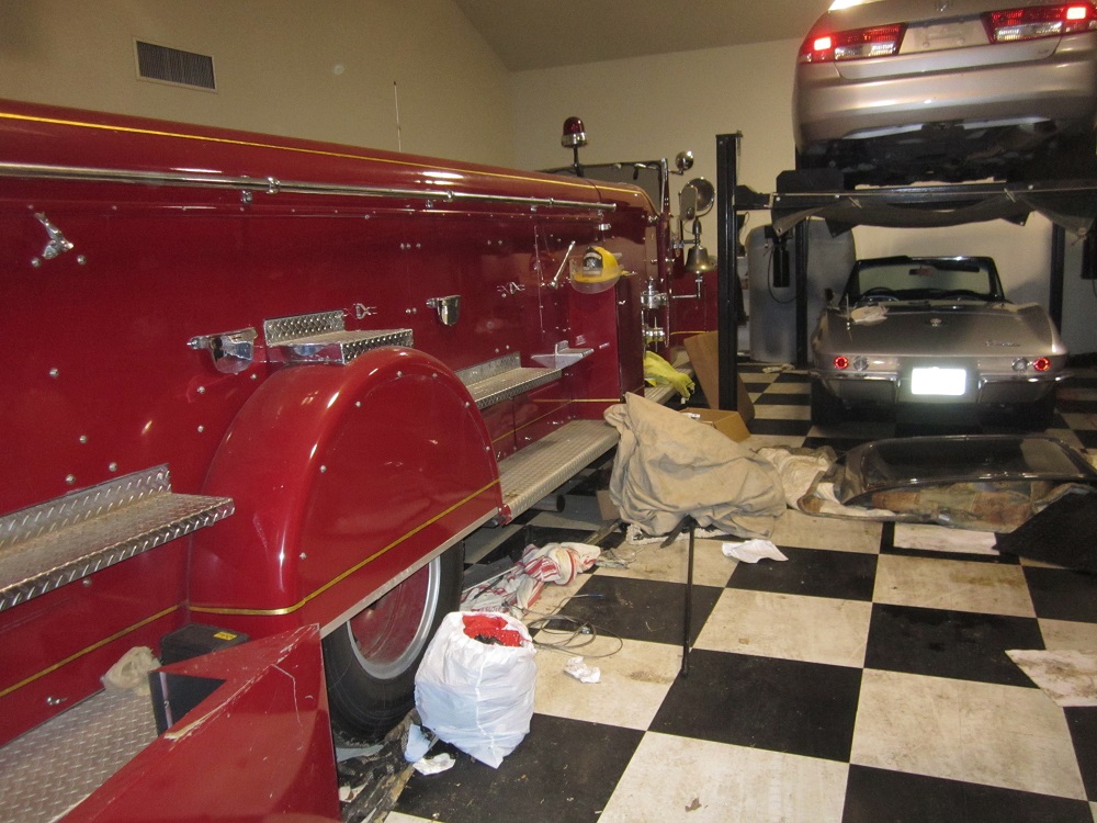

Where is that Vette Shootout? I have a 65 bought new. Can we run with plug guards on it? Phish
