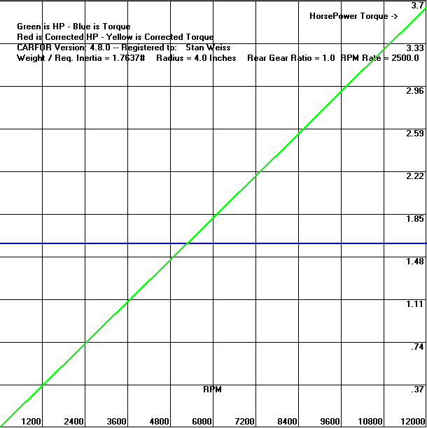

100 grams * 8 = 800 grams / 1.7637 lbs
Let say that weight is at a 4" radius with an acceleration rate of 2500 RPS.
Stan
