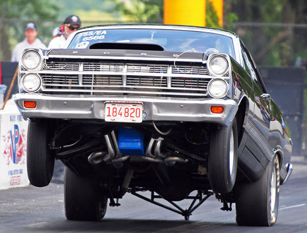

Wheelstand... What wheelstand? Looks good to me.

How about a posting a photo of the mustang on the bumper Dale? I missed it in person that day....
