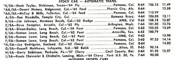

The earliest 383/343 example I can remember in Division 7 was a '62 Dodge driven by Jim Johnson (not THE Jimmie Johnson) of Hermosa Beach, California and later by Joe Ross. I recall that it was run regularly in 1963 and was a record holder in 1964 (see attachment). I believe that it was a Polara 2 dr. hardtop and I'm sure that it had bucket seats.
Name:	1964 Records.jpg
