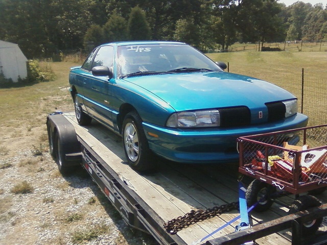

OK, there was the thread on Pure Stockers. Well, what if you had a car? I've acquired an 1995 Olds Achieva. It has the DOHC 155hp (NHRA rating w/auto), 2.3L 4 cyl. It is a FWD, 2 door, auto trans. If the IHRA and NHRA hp ratings are the same, the car fits in I/PS. Using the 16.00 lbs as a minimum, NHRA guide shipping weight is 2619. So if my math is right, the car would weigh 2650 lbs. Looking at indexes, the 1/4 mile is 14.55, 1/8 is 9.45.
If I can find the time. I have an 1/8 outlaw track 6-7 miles from the house. May just have to throw the thing on the trailer and see how it really runs. Don't really have the time or space for another project but just what I need is an excuse to go to the track.
Next thing, a FWD car. What do you do with these things? Here's a picture of the car.

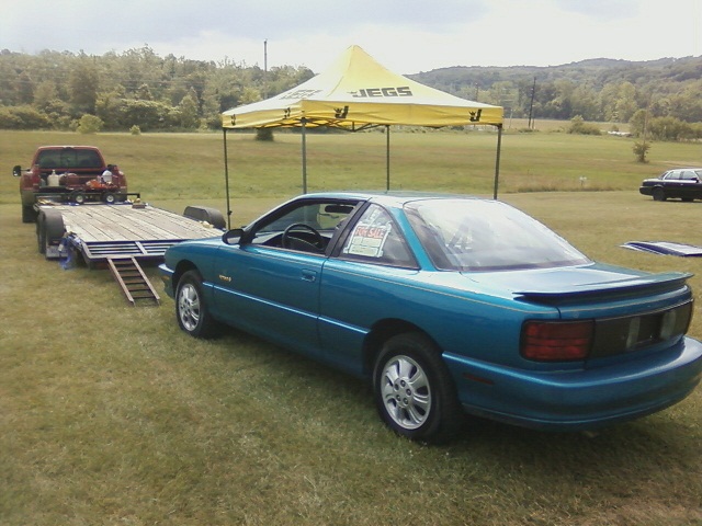

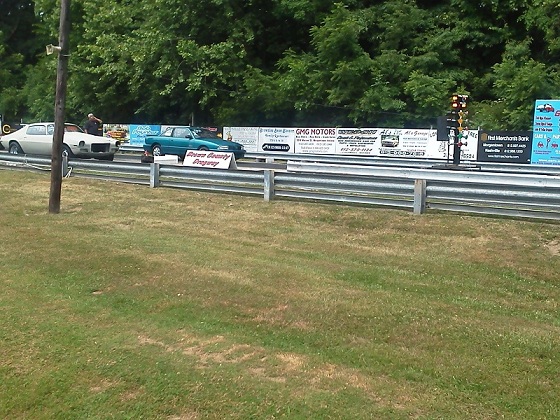

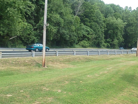

Well it was an interesting day at the track. We made 4 practice passes with the car. First pass was an 11.801, second pass 11.712, third 11.731, fourth was 11.533. Only thing we could surmise, on the last practice pass, we allowed the car to cool for a longer period. First three passes were all made within 15-20 minutes of each other. Last pass the car may have sat for at least 30-35 minutes, maybe longer. We didn't record that.
For eliminations, we dialed the car at an 11.60. I cut a really crappy light. My opponent treed me, he ran a 8.61 on an 8.57 dial in. I ran a 11.607 on an 11.60. The guy was pitted next to us, he hadn't cut a good light all day, until we ran!
With the object being baselining the car for I/PS. We're way off the 1/8 mile index of 9.45. That's with nothing being done to the car. Just staging the car, leaving it in Drive and steering it down the track. Got work to do on our other cars. I may clean the throttle body (or whatever this thing has), maybe put a fresh set of plugs in it. Then maybe take it back in a couple weeks or so and see what those little improvements do. Unless I sell the car, then that frees up time and money to get my "real" cars finished, LOL!!!
Also got to meet another member of our board. Dennis Roberts and his wife Carol were pitted next to us with their H/PS Malibu wagon. I appreciate that he was willing to listen to my many questions. It's always great to leave the track and make new friends. He had some good tips for us, should we decide to pursue this car farther.
