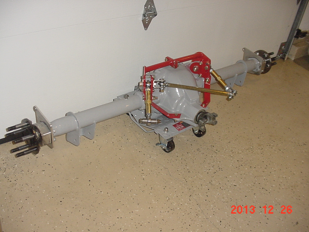

Here is the Baseline Suspensions Outlaw Kit installed on the 8.8, ready to go into my SN95 . Instructions, fit and finish were excellent..

Just ordered the Team Z version... http://www.teamzmotorsports.net/product_p/tzm-uca1.htm

I don't believe you can move pivot points fore and aft in Stock.
I saw a 78-79 GM Stocker last year that had a home made setup like that team Z deal.
It was setup to use a shorter upper control arm to change the instant center on the car.
I'm going to read the rulebook again, but I do not remember where it said you cannot change the pivot point of the upper control arm at the rear end.
On the car's body/chassis, yes, you cannot move that, but I am not sure about the rear end attachment point.
P/SA & SS/PA Fox Thunderbird
