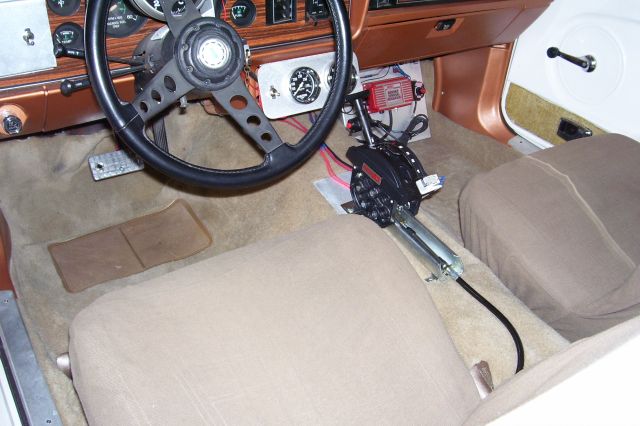

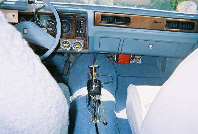

Over ... or under
ID:	32602   Click image for larger version
