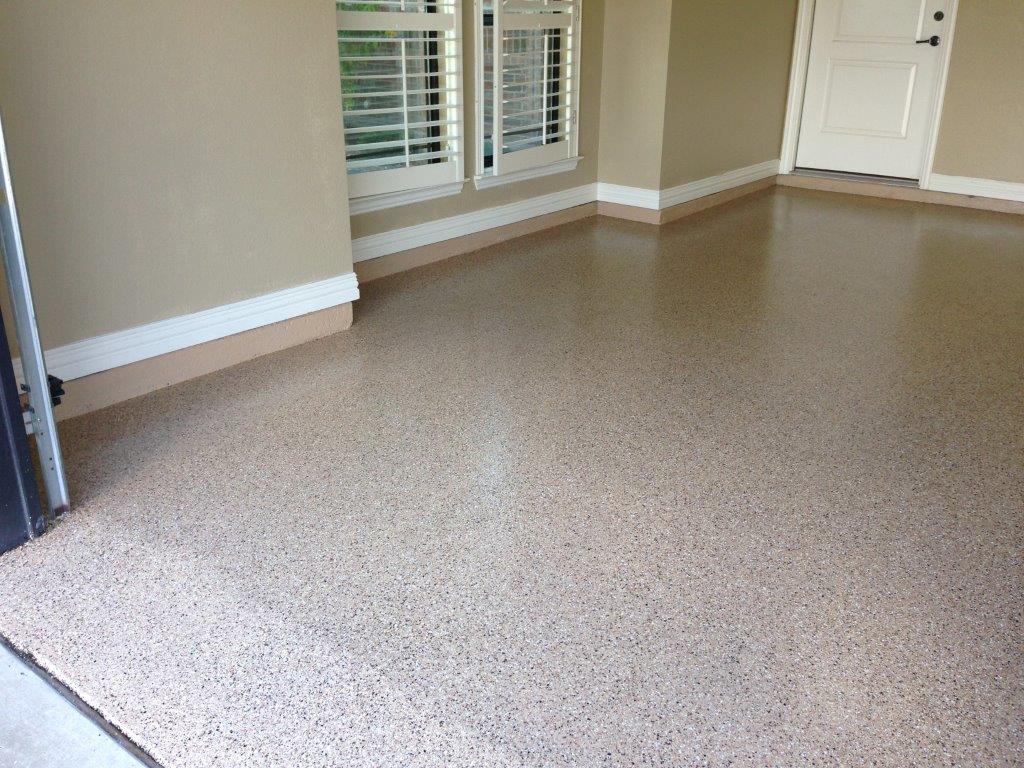

Garage floor was done yesterday Looks fantastic and very good job I would highly recommend any one in the Dallas area to try these guys out.
Tried to upload photo but says too big can't seem to figure out how to load it

Put the pic on photobucket and then copy the IMG URL from there....free accounts...

Name:	garage floor.JPG
