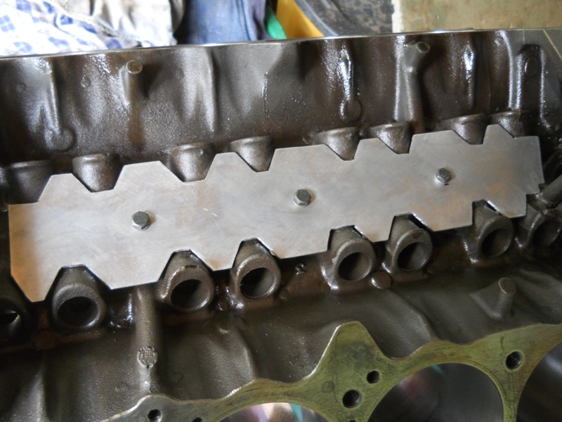

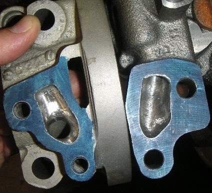

These little modifications may also help?

Peter Ash 6100 STK
