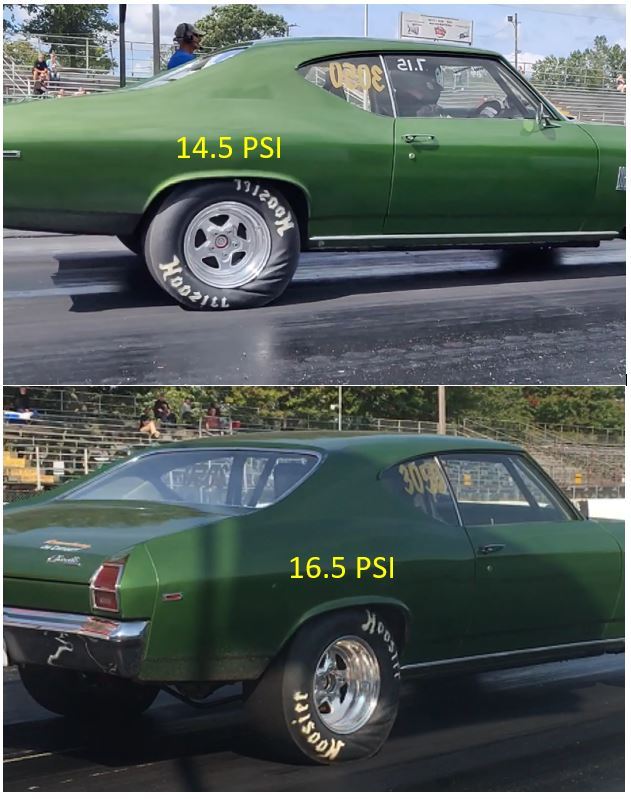

Update. I went to Milan on Sunday (9-27-20) and bumped the tire pressure up 2# to 16.5 for the one and only time run I got. Car launched hard and the 1/8th picked up .02 and 1mph from previous runs in similar air for my Dad. I ran my best et and mph ever with the car. 11.20 @ 119.75 mph @ 1950 DA. Video looked good too. Below is a still of the difference from the 14.5 and 16.5psi launches at the same 3600 rpm and all other aspects of the car being the same. Dad is racing Friday night at Milan in Open Comp and we are going to push him to put 18.5 psi in the tires for Q1.
Open Comp is a .500 PRO tree, qualifying on reaction time class w/ no dragsters or delay boxes. Your dial-in all night is .10 faster than your best Qualifying ET. 56 car field and I have seen as many as 89 cars trying to qualify with the bump being as low as .039 RT! Lots of whomping at the stripe and brake lights too. Dad is tied for 10th in points, which is pretty darn cool.

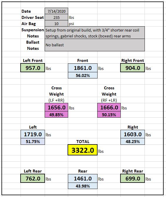

For reference and because I like seeing numbers and data, here is the corner weights of the car prior to installing the Qa1 Rear Upper control relocation kit at the diff. Other reference items to note. Car as weighed this day and as we race it now has 4 wheel iron drums, Diehard big battery in the stock RF location and the car does not have any ballast bars or boxes in it. 10 gal alum fuel cell in the middle and rear of the trunk. Memory was about 7-8 gals in the cell when we weighed it. Kirkey seats, no rear seat.
DVD players in the headrests, 12" sub box in the trunk and R12 a/c too (all kidding...)
