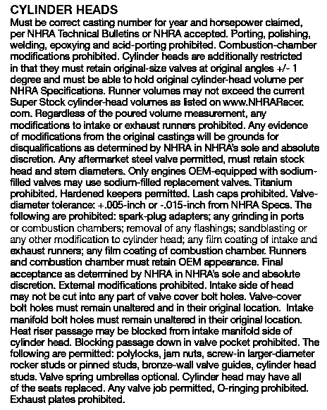

I have not done an stock eliminator heads but looking at the rules, I do find it interesting what is being talking about. It looks to me the only area one can get creative is the valve job.
Stan

You need to read the gray area part of rules. Most of the heads are ported( acid and others ways the camouflaged) to pass tear downs!
Stan
