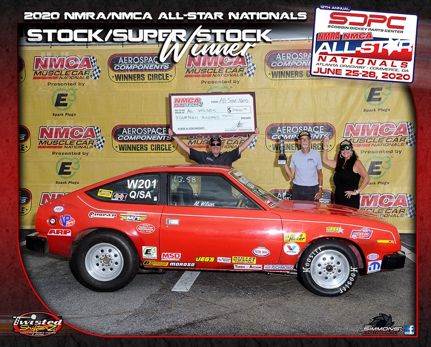

I have a slow car, but you know, when I first started going to the track and racing in the 60's and 70's this would have been a fairly fast car.
Took me about a year to get it dialed in and get comfortable in it. I've found you have to be dead on with the shift points. I also keep track of the weather and use prediction software.
If you don't mind, What's the Car (AMC?) & combo?
Thanks
HR3128 is offline   Reply With Quote
Old 01-28-2021, 06:20 PM   #30
Al Wilson
Join Date: Apr 2018
Location: Dunnellon, FL
Posts: 75
Likes: 158
Liked 109 Times in 38 Posts
Default Re: Lower Class Imput
Thanks
It's a '79 AMC Spirit, 304 V8, 125/180 HP. Former Bub Miller, Eric Pearson, Mike Meier car.
