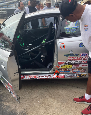

Are there any photos available of the damage to Jimmy’s GTO?

Here are some photos. This could have been REALLY bad. I have an unconfirmed rumor that the back of the crankshaft broke off. I'm not sure if this is true or not.

I was in the barn when they pulled the trans.
Crankshaft was not broken. What remained of the flexplate was still bolted with all bolts to the crank. Approximately 2/3 of the flexplate was still there.
Parts of flexplate and ring gear were gone. The Trans case bell and ears were broken off.

Originally Posted by The Hawk View Post
What happened?
The car in the other lane exploded the flex plate on the burn out.

I'm standing over the wall from the water box.
Bashum started his burnout & the flywheel ring gear came apart.
I have a inch & half piece that I picked up.
Went through the 1/4 panel & busted out the right side 1/4 window.
Could have been worse.

Oh my God bad is not the word!! Thank God he didn’t stop a few inches sooner. Thanks for the photos and I’m glad both drivers are good. Thank You Lord.
