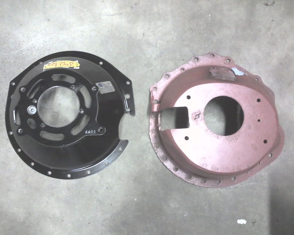

Here are a couple of pictures I took when we originally moved to the QT bellhousing (pre SFI windowed version). It makes the Lakewood bellhousing seem huge!
From the top
From the side
Joe Schaechter 3168 STK

My Lakewood housing is 37 pounds including block plate and bolts. The quick Times can is 27 pounds including same parts. Bathroom scale but still a relative comparison.
