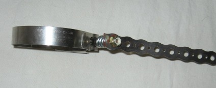

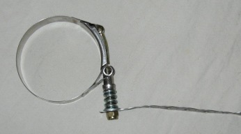

This is what I was going to use as a secondary option #3,but the clarification is so vague!.
ID:	22998   Click image for larger version

HandOverFist
HandOverFist's Avatar
Join Date: Oct 2013
Location: Gulf Breeze, FL
Posts: 1,651
Liked 33 Times in 16 Posts
Default Re: Header Retention Rule Revision
Got casters on the bottom?
Rich Taylor
I/SA - 321
Old 03-01-2014, 09:27 AM   #90
Randall Klein
Location: Lincoln, Nebraska
Posts: 785
Likes: 45
Liked 316 Times in 67 Posts
Very funny, but, No.
Plumbers strap prohibited.
Of course you know that, but thanks for the chuckle, with the winter we are experiencing any laugh helps
