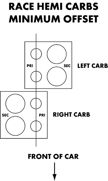

If I decide to move to SS can my Max Wedge use the same style intake design as the SS/AH cars, if so, what is the offset for the carbs?

I had asked NHRA the same thing for my current SS project and I was told that the carbs can have the primary bores inline.

Rh
