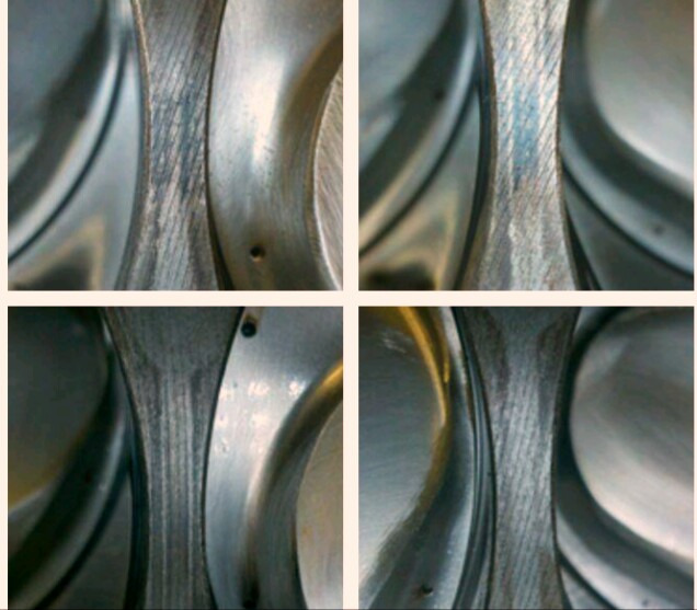

Default Re: cometic head gaskets
I have a big Chevy from Schmidt that failed between 5-7 due to cutter marks using cometic gaskets. Only posting to say that composite is my only fix but why is the cutter pattern not the same between bores. It's as if the block machine was cutting at angle (side to side) making most of the between bore deck verticle pattern and others a bit more /// direct between bores. Is there a standard for deck tooling path? I just assumed parallel to crank. Sorry if I'm hi-jacking.
Thanks
Bryce
Thanks
Bryce
Bryce,
The finish should be the same across the entire deck surface including between the bores. Here is an Olds block I just finished.

Bill,
That is a fantastic finish. Here's the Steve Schmidt finish and the difference in pattern and where the combustion escaped.
Pretty terrible. Thanks for sharing.
Bryce
Bill,
Bryce
Good grief that is pretty terrible for a modern shop. Wonder if someone wasn't paying attention
